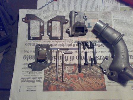

No no... the boost port and the transfert duration will be the same.... at the moment it is different but i will modificate the transfert port from 120 grades to 130 grades like boostport. Ciao Romeo ancora non conosco le fasi di aspirazione della valvola e al cilindro.... perchè non ho ancora ricevuto il pacco da DRT. -

Here the UPDATE! You can see the new quarry on the piston for lubrication and a new orientation of the aspiration to the top of the cilinder. The phase is 130 grades -

Hello GERMAN BOY! I want to present you my new motor composed by: -130 polini double admission -Mazzuchelli crank 53 mm -PHBL 24 -DRT cluth with 4 disc surflex modificated, "Kupplungsabdeckscheibe" and "innerer Kupplungskorb" -Schaltkreuz/Schaltklaue DRT -24/61 -Pk flyweel 1,6 kg (6 poles ignition et3 compatible) i'm waiting for the crank from denis because there is a delay on the delivery! Let's take this photos for the moment......i accept any kind of question! i update as soon as possible! BYE
