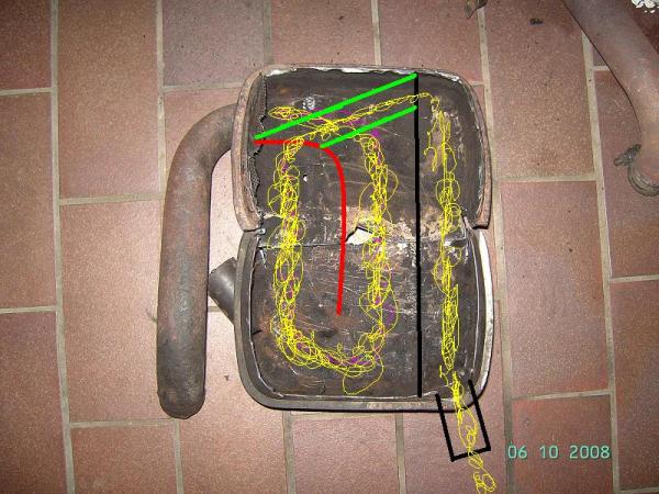

Hi, i'm from spain, and mi english is very limited. I'm new here, is my first post and i have an idea to do with a original exhaust. Can it be good, or will be too much noisy?
Thanks :-D
Thanks :-D
In Bensheim und Spanien gibts die selben Fußböden! Was ein Zufall!!
Bearbeitet von Melkfett
........................ :-D:-D ............................ ich krieg mich nicht mehr ein!
Hi again, I have another idea to make the exshaust, is quieter than first, But maybe it give less power, i don't know. The idea is to cut the end of the inlet tube to open it, and add a second exit.
What do you think? Can it be good?
See you :-D:-D
