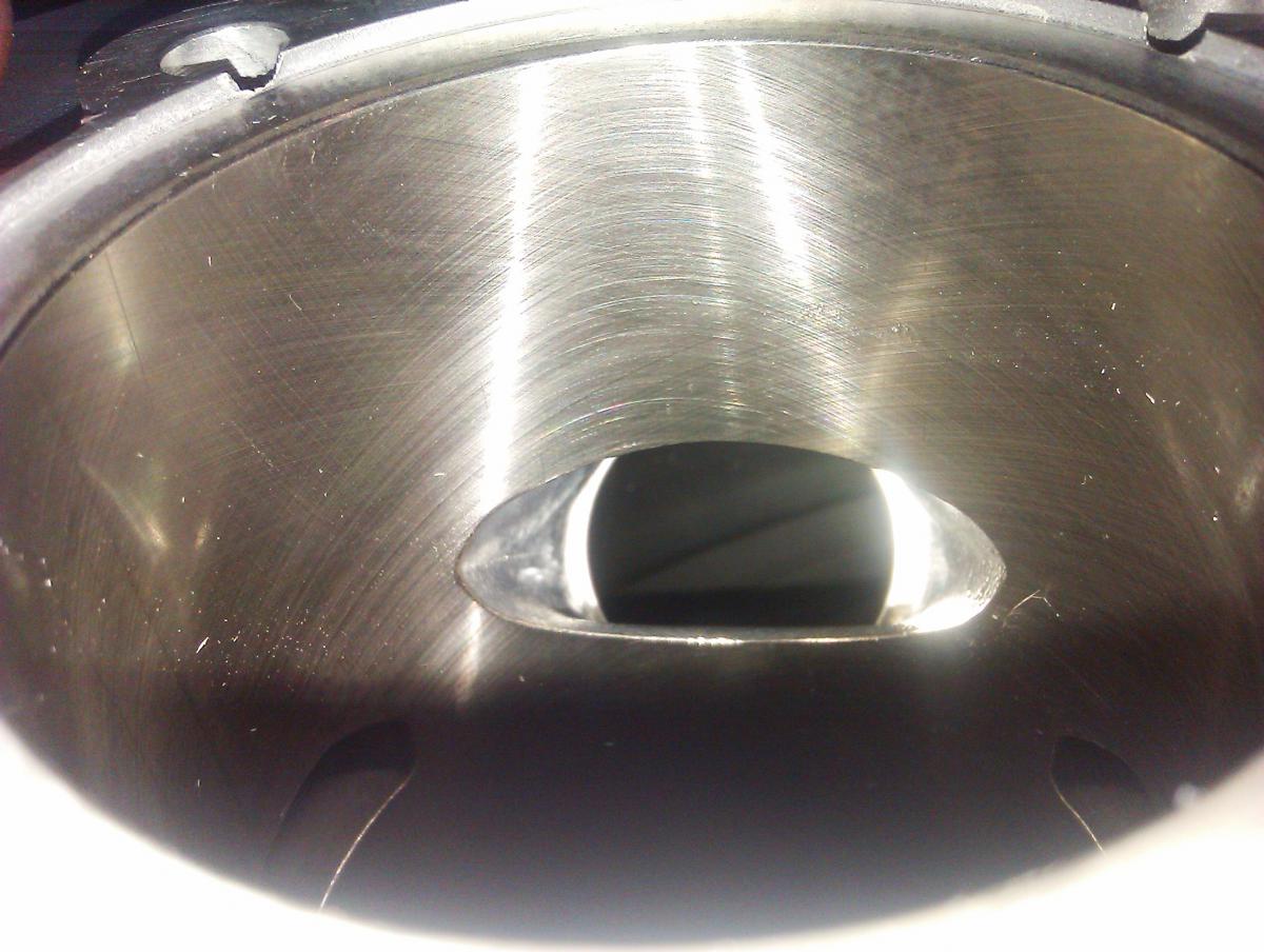

For a daily use, and a good torque, is it better to keep the original Polini EVO exhaust shape and just add a few millimeters (to increase de blowdown to 185°) or to change the shape as the third one ? Maybe the third is better for a race use ?
Bearbeitet von keuk
only increase a little bit.
in the width up to 68-69%.
Weißt du, wie breit der original ist?
I think the lower part of the port is a bit strange. I'd go for a happy medium between 2 and 3.
For daily use I'd recommend leaving the exhaust port as is, then jet the engine, finetune the spark timing and see how you like it. Then, if necessary, I'd perform one to several alterations until I get what I want.
Bei mir sind das von Haus aus knappe 70%, aber auch bei 68-69 würde ich das einfach erst mal so lassen.
Port timing:
What's your target? With the kit as it is I'd expect around 15 BHP or so. If that's enough for what you intend to use it for I too would leave it as it is.
I would like to adjust the timings to use it with a PM40, If I remember rightly I should have 185 to the exhaust.

So for a daily use, is it better to have 185 or 180 with 30* blowout ( with pm40 / koso 28 / lighter flywheel...) ?
