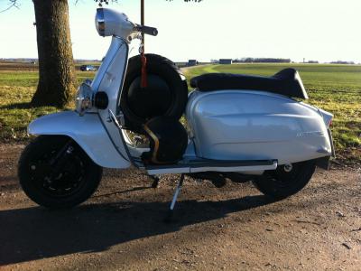

Meine LI 125 s3 Arthur Francis S-Type Style
