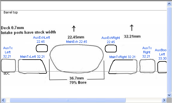

Ok, lets see what we have here: Malossi Suzuki Conversion. I think, the cylinder is made by Malossi. Hmm yes, taking a look into the cylinder and it looks very similar to the malossi system. The "original" piston for the malossi was a 68,5 mm Asso piston. The drilling looks a little bit greater. Vic says 70 mm piston. So the Asso piston is out and the 70 mm Szuki piston goes in. Remeasuring helps. A portmap will help, like this . We need this later.
I whould check, if the piston rings fit with the cylinder, like this
the distance between the end of the pistong rings should not go below 0,3 mm and should not go over 0,9 mm
You should be sure, that the piston rings do not feather in the "above-streams" or the "outlet"
