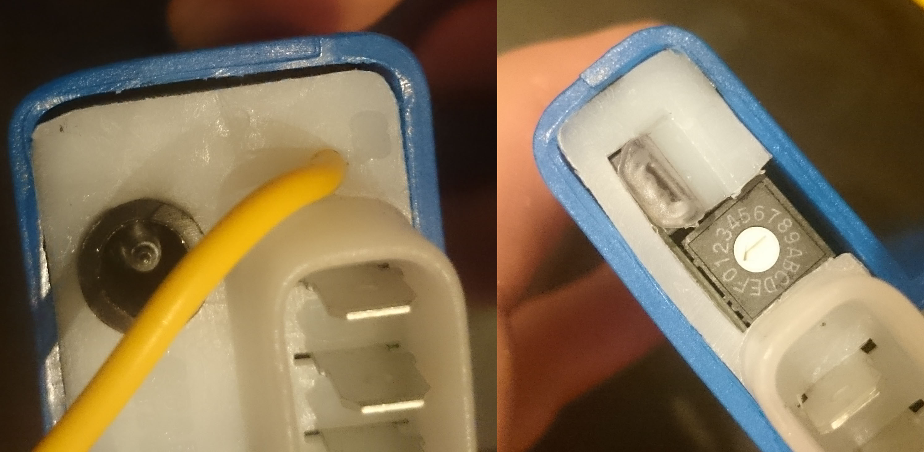

Wg spalt zw blau und weiss:
Thanks for your question, so behind the white plastic part all the electronic is immersed in the epoxy resin to isolate it from water projections, nevertheless if you would like to improve the waterproofing of the product you could probably fit on the emarket som rubber caps:
Kind regards,"
