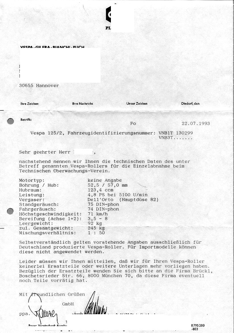

Sheet with original parts: no. But a Data sheet ...
IMHO your plate does not fit to the italian libretto. Or is the german number (VNB1T 129xxx written in the libretto?  :blink:
post-1023-0-24647500-1431992198_thumb.jp
Thank you t4 :)
The plate is fitted to the italian libretto and is the german numer. If I don't wrong, the vespa is german and in the 1966 had been registered in Italy with italian libretto and the other documents.
